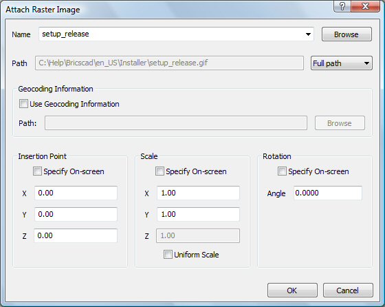

Specify options, and then click OK.

Options
Name

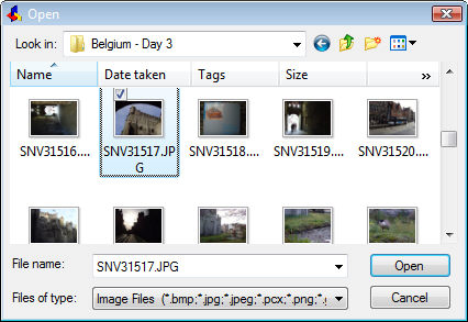

Specifies the file name of the image.
Browse
Displays the Open dialog box; click this button to choose a different raster file.
Choose a raster file, and then click Open.
Path
Reports the path to the image file; cannot be edited by the user.
Full Path
Determines how much of the path is stored:
  • Full Path - stores the full path to the file, including drive and folder names. For example:
c:\foldername\imagename.ext
  • Relative Path - stores the path from the drawing's location to the image's location; the drawing must be saved before this option can be selected. For example:
..\foldername\imagename.ext where .. refers to the folder above the current one.
  • No path - the path is discarded.
Geocoding Information
Position files or world files have an extension that depends on what kind of image file they are associated with.
See explanatory notes below: "About Geocoding Information".
Use Geocoding Information
Toggles use of a position file, which specifies the size, location, and rotation of the image file:
  • Yes - uses a position file.
  • No - does not use a position file.
Path
Reports the path to the position file.
Browse
Displays the Select Image Position File dialog box; choose a TWF file, and then click Open.
Insertion Point
Positions the lower left corner of the image in the drawing. This option is unavailable when a position file is used.
Specify On-screen
Toggles where you specify the insertion coordinates:
  • Off - Specifies the x,y,z coordinates in the dialog box.
  • On - Specifies the coordinates after you click OK, in the command bar:
Insertion point - specify the x,y or x,y,z coordinates of the image's lower left corner.
X
Specifies the x coordinate of the image's lower left corner.
Y
Specifies the y coordinate of the image's lower left corner.
Z
Specifies the z coordinate of the image's lower left corner.
Scale
Sizes the image. This option is unavailable when a position file is used.
Specify On-screen
Toggles where you specify the scale factors:
  • Off - Specifies the x,y,z scales in the dialog box.
  • On - Specifies the scales in the command bar after you click OK:
Scale factor - specify the scale factor.
X
Specifies the scale factor in the x direction:
  • Values larger than 1 make the image larger.
  • 1 inserts the image at actual size.
  • Values smaller than 1 make the image smaller.
Y
Specifies the scale factor in the y direction
Z
Specifies the scale factor in the z direction.
Uniform Scale
Makes the Y and Z scale factors equal to X.
Rotation
Rotates the image about the insertion point.
Specify On-screen
Toggles where you specify the rotation angle:
  • Off - Specifies the angle in the dialog box.
  • On - Specifies the angle  in the command bar after you click OK:. Prompts you:
Rotation angle - specify the angle.
Angle
Specifies the rotation angle about the insertion point.
  • Positive angles rotate the image counterclockwise.
  • Negative angles rotate the image clockwise.
