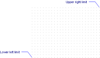

Limits are off: ON/<Lower left corner> <0.0000,0.0000>: (Enter x,y coordinates or pick a point.)
Upper right corner <12.0000,9.0000>: (Enter x,y coordinates or pick a point.)
When limits are on, they prohibit drawing outside of the area defined by this command.
Bricscad reports, "Selected point is outside limits. Please select another point."
The area also defines the extent of the grid display, whether limits are turned on or off.

Lower left corner
Specifies the lower left corner of the limits.
Upper right corner
Specifies the upper right corner of the limits.
