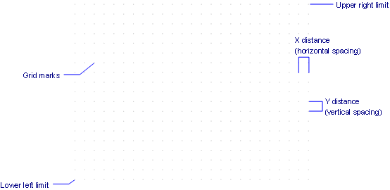

Changes the aspect ratio of the grid; prompts you:
Horizontal Spacing - specify the x distance between grid dots.
Vertical Spacing - specify the y distance between grid dots.

Specifies the distance between grid dots:
  • X - spacing between dots in the x direction.
  • Y - spacing between dots in the y direction.
There is no grid in the z direction.
