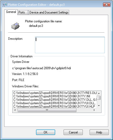

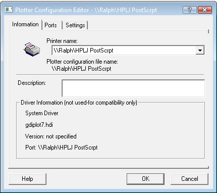

Displays a window:
To edit an existing plotter configuration file, double click a PC3 file, such as default.pc3.
Make changes the properties, and then click OK.

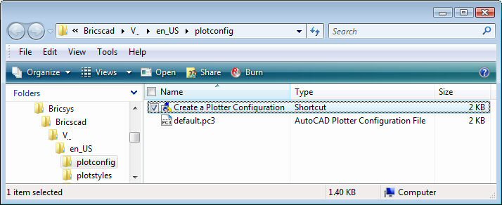

To create a new plotter configuration file, double-click the Create a Plotter Configuration shortcut.
Select the properties, and then click OK.

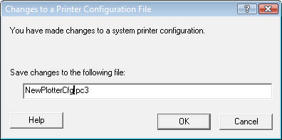

You are prompted to name the new plotter configuration file:
Enter a name, and then click OK.
The new PC3 file is added to the C:\Users\<loginname>\AppData\Roaming\Bricsys\Bricscad\V...\en_US\plotconfig folder.
General Option
Describes the plotter configuration; displayed in tooltips.
This field is optional.

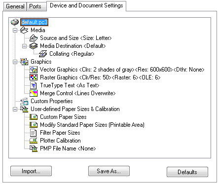

Device and Document Settings Option
Media
Specifies settings for the media (paper).
Specifies how to collate pages:
None - does not collate; drawings are printed normally.
Regular - prints layouts of each drawing together.
This option is useful when printing multiple copies of drawings with multiple layouts.
Graphics
Specifies how graphics are handled by the printer.

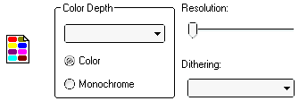

Vector Graphics (currently NOT supported)
Specifies how vector graphics are handled:
Color depth - specifies the number of colors to use.
Color - outputs the drawing in color.
Monochrome - outputs the drawing in monochrome (black).
Resolution - adjusts the resolution; lower resolution is coarser, but prints more quickly.
Dithering - specifies the type of dithering, which simulates more colors at the cost of lower resolution.
Vector graphics are normal Bricscad drawings made with lines, arcs, and so on.

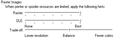

Specifies how raster vectors are handled:
Raster - adjusts how raster images are handled.
OLE - adjust how OLE objects are printed; ranges from:
  • None - does not print OLE entities.
  • Best - prints OLE entities at highest quality.
Trade-off - specifies how Bricscad should handle drawings with very large raster images that take up much memory:
  • Lower Resolution - prints images with lower resolution but full colors; suitable for photographs.
  • Balance - prints images with as many colors and as much resolution as possible.
  • Fewer Colors - prints images with fewer colors but full resolution; suitable for grayscale images.
Raster graphics are images attached to drawings.
Specifies how TrueType text is handled:
  • TrueType as text - prints text as text; preferred when the printer holds the needed fonts.
  • TrueType as graphics - prints text as graphics; preferred when drawings are printed to files.
Specifies how overlapping lines are merged:
  • Lines Overwrite - specifies that entities with higher draw order overwrite other entities.
  • Lines Merge - specifies that entities are blended to merge their colors; allows entities with lower draw order to be seen.
Custom Properties
Accesses the Custom Properties dialog box.
This dialog box lists properties unique to the selected output device.
Its content varies according the capabilities of the device.

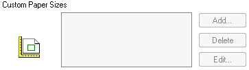

User-Defined Paper Sizes & Calibration
Specifies custom paper sizes.
Add - adds user-defined paper sizes.
Delete - removes custom paper sizes.
Edit - edits custom paper sizes.

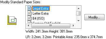

Modifies the margins on standard paper sizes:
Modify - displays the Custom Paper Size - Printable Area wizard. See below.

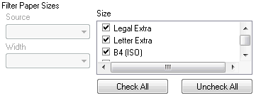

Reduces the number of paper sizes. The list of paper sizes normally shows all sizes that the output device is capable of handling. In reality, you work with just a few sizes.
Click checkboxes next to sizes you don't want displayed by the Print dialog box.
Check All - includes all paper sizes.
Uncheck All - excludes all paper sizes.
