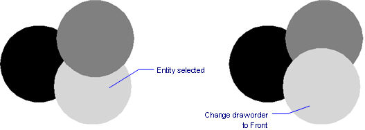

Changes the display order of overlapping entities.
command bar: draworder
alias: dr
menu bar: Tools | Draw Order
toolbar: Draw Order |
: draworder
Select entities to change draw order: (Choose one or more entities)
Change draw order: Above/Under/Clear/Front/<Back>: (Enter an option.)
Selects one or more entities; this command is meant to work with overlapping objects. |
Moves the entities above other entities, but not necessarily to the top (front) of display order. |
Moves the entities below other entities, but not necessarily to the bottom (back) of display order. |
Clears assigned display orders; entities are displayed as they were originally created. The last created entity is displayed on top of one created earlier. |
Moves the entities' display order above all other entities. |
Moves the entities' display order below all other entities. |
