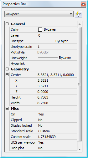

Defining viewport properties
  1. Select the viewport.
    If you select a clipped viewport, click the Selected Entities button on top of the Properties Bar, then choose Viewport in the list.
The viewport properties display in the Properties Bar.
If you select a clipped viewport, click the Selected Entities button on top of the Properties Bar, then click Viewport in the list.
  1. Click the settings field of a property to modify.
Properties
Name
Center
XYZ coordinates of the center point of the viewport.
To specify the center of the viewport graphically, drag the center handle of the viewport.
Height (*)
Height of the viewport in drawing units.
To specify the height of the viewport graphically, drag the top or bottom handle of the viewport.
Width (*)
Width of the viewport in drawing units.
To specify the width of the viewport graphically, drag the left or right handle of the viewport.
On
Controls the display of the content of the viewport.
Clipped
Allows to create non-rectangular viewports.
Display locked
Locks the scaling of the viewport content to preserve the scaling factor.
Standard scale (*)
Lets you choose a standard scaling factor.
Custom scale (*)
Lets you define the scaling factor in a decimal format. Displays the current scaling factor.
UCS per viewport
If Yes, lets you define a UCS for this viewport.
Hide plot
Controls whether the viewport boundary is plotted or not.
(*) You must choose the width and height of a paperspace viewport with respect to the viewport scale.

Setting the scale of a paper space viewport
  1. Switch to paperspace.
    (See Toggle between model space and paper space)
  2. Click the viewport border.
    The viewport properties display in the Bricscad Properties Bar.
  3. Do one of the following:
  4. Choose a scale in the Standard scale list.
  5. Type a scaling factor in the Custom scale field.
The display of the viewport is scaled with respect to the layout size.
  1. (option) If necessary, adjust the size of the viewport to the new scale.
  2. (option) Set the Display Locked property to Yes.
