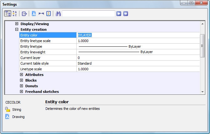

: ddemodes
Displays Settings dialog box at the Entities section:
Change settings, and then click X.
Entity Color
Specifies the default color of new entities; default is ByLayer, which means that entity colors are governed by layer properties.
Entity Linetype Scale
Specifies the default scale factor for linetypes; default is 1.0000.
Entity Linetype
Specifies the default linetype for new entities; default is ByLayer, which means that entity linetypes are governed by layer properties.
Entity Lineweight
Specifies the default linetype for new entities; default is ByLayer, which means that entity lineweights are governed by layer properties.
Current Layer
Specifies the default layer for new entities; default is layer 0.
Current Table Style
Specifies the default table style for new tables.
Linetype Scale
Specifies the global linetype scale factor; this factor affects entity linetype scale factors.
