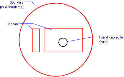

Island detection
Toggles whether islands are hatched over or not:
Do you want island detection? - enter an option.
  • Yes - all islands are made into boundaries, as well as the outermost area.
  • No - islands are ignored; boundary is created of outermost area only.
  • Outer only - ignores innermost areas; boundary is created between outermost area and islands.
