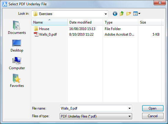

Displays the Select PDF Underlay dialog window.
Select a PDF file, then click Open.

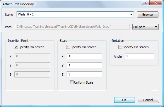

BricsCAD displays a dialog box:
Name
Specifies the name of the attached PDF file.
If more than one PDF file has been attached to the drawing, their names are listed by the droplist.
Browse
Choose a PDF file, and then click Open.
Path
Click the droplist to choose a different path type:
  • Full path - stores the drive and folder(s) names to the PDFfile (absolute reference), such as: c:\cad\PDF\filename.pdf
  • Relative path - stores the route to the referenced PDF file's folder, such as: ..\filename.pdf
    This option does not work until the drawing has been saved at least once.
    (..\ means one folder higher.)
  • No path - strips the drive and folder(s) names, leaving just the PDF file name, such as: filename.pdf.
Insertion Point
Specifies the location of the underlay's lower-left corner.
Specify On-screen
Determines when the insertion point is specified:
  • On - specify the insertion point in the drawing after the dialog box is closed; you will be prompted:
Insertion point for block - pick a point or enter x,y,z coordinates.
  • Off - specify the insertion point in the dialog box using the X, Y, and Z fields.
X
Y
Z
Specifies the x,y,z coordinates for the underlay's insertion point.
Use 0,0,0 to insert the underlay at the drawing's origin.
Scale
Specifies the size of the PDF underlay.
Specify On-screen
Determines when the scale factors are specified:
  • On - specify the scale factor in the drawing after the dialog box is closed; you will be prompted:
Corner/XYZ/X scale factor - enter an option, pick two points a number, or press Enter for the default value.
Y scale factor:  < Equal to X scale> - enter an option, a number, or press Enter for the default value
  • Off - specify the scale factor in the dialog box using the X, Y, and Z fields.
X
Y
Z
Specifies the scale factors of the underlay in the x, y, and z directions.
Use 1,1,1 to keep the underlay at its original size.
Rotation
Specifies the rotation angle of the PDF underlay.
Specify On-screen
Determines when the rotation angle is specified:
  • On - specify the angle in the drawing after the dialog box is closed; you will be prompted:
Rotation angle for block - enter a number, pick two points, or press Enter for the default value.
  • Off - specify the angle in the dialog box using the Angle field.
Angle
Specifies the rotation angle about the insertion point.
Positive angles rotate the underlay counterclockwise.
Use 0 to keep the underlay at it original orientation.
