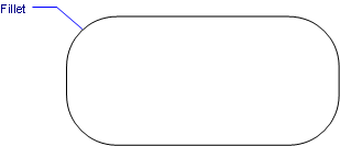

Fillet
Applies a fillet radius to all four corners.
When fillet radius = 0, prompts you:
Fillet distance to use for all rectangles - specify the fillet radius; enter 0 or a positive number.
When fillet radius not 0, prompts you:
Off/Default/Fillet distance to use for rectangles - enter an option.
The same fillet is applied to all four corners.
Caution: when the fillet radius is larger than the rectangle, an invisible rectangle is drawn.
See Fillet command.
Off
Turns off filleting; uses 0 as the fillet radius.
Default
Uses the default fillet radius as stored by the Rectang command.
This command does not use the FilletRad system variable.
Specifies the fillet radius; enter 0 or a positive number.

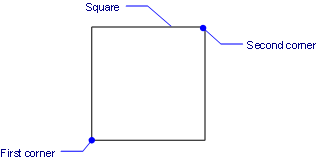

Square
Draws a square; delays the prompt until after the 'Select first corner of rectangle' prompt:
Second corner of square - specify the opposite corner; pick a point, or enter x,y coordinates.
See Polygon command.

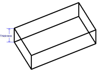

Thickness
Specifies the thickness of the rectangle.
When thickness = 0, prompts you:
Rectangle thickness - specify the thickness; enter 0 or a positive number.
Default/Rectangle thickness - enter an option.
The thickness is the height of the rectangle in the z direction; it is measured upwards from the elevation.
See Elev command.
Default
Uses the default thickness as stored by the Rectang command.
This command does not use the Thickness system variable.
Rectangle thickness
Specifies the thickness; enter 0 or a positive number.
