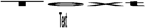

Fit
Specifies fit justification.
Fits text between two points and prompts for the height; prompts you:
Text start point - specify the staring point of the text.
Text end point - specify the end point for the text.
Height of text - specify the text height.
This option supresses the angle prompt, because the angle is determined by the two pick points.
Entering certain heights can cause the text to be excessively elongated or squeezed.
Use this justification to force text to fit in an area, such as a closet.

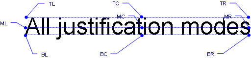

Justify
Displays all justification modes; prompts you:
Text: Style/Align/Fit/Center/Middle/Right/TL/TC/TR/ML/MC/MR/BL/BC/BR/<Start point> - enter an option.
  • TL - top left
  • TC - top center
  • TR - top right
  • ML - middle left
  • MC - middle center (equivalent to Middle).
  • MR - middle right
  • BL - bottom left (equivalent to Start Point).
  • BC - bottom center (equivalent to Center).
  • BR - bottom right (equivalent to Right).

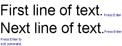

Text
Specifies the text.
Enter a line of text, and then press Enter.
The prompt repeats; enter more text.
Each additional line of text is positioned under the previous line.
Exit the command by pressing Enter at the 'Text' prompt.

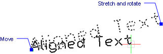

Grips Editing
Text can be moved directly through grips:
  1. Select the text face. Notice that it has one grip at its insertion point.
  2. Drag the grip to move the text.
Aligned and fitted text have two grips:
