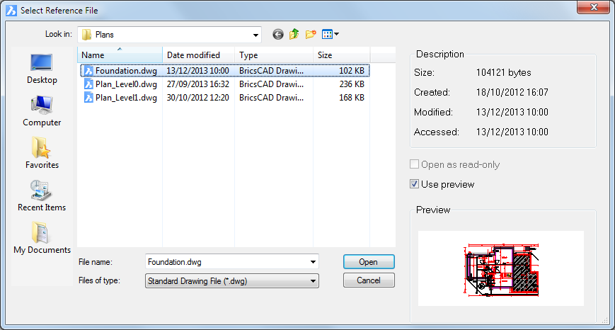

Choose a DWG file, and then click Open.

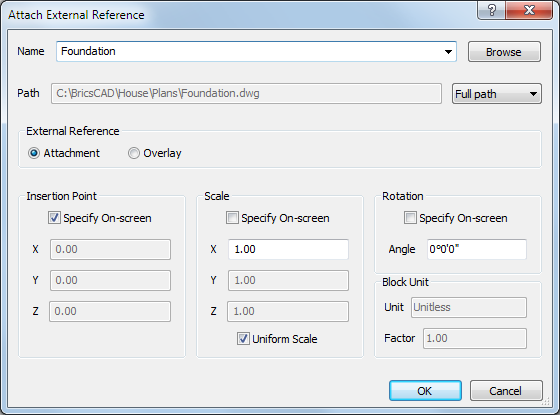

BricsCAD displays a dialog box:
Choose options, and then click OK.
If you choose Specify On-screen, then you will be prompted in the command bar for the insertion point, scale, and/or rotation angle.
This command is a shortcut to using the -XRef command's Attach option.
Name
Specifies the name of the attached drawing file.
If more than one DWG file has been attached to the drawing, their names are listed by the droplist:
Choosing another name lets you modify the xref's properties.
Browse
Displays the Open dialog box.
Choosing another file lets you attach a additional drawings without leaving this dialog box.
Path
Reports the path that will be remembered by BricsCAD.
You cannot edit this field; instead, use the Browse button to modify the path to the file.
Full Path
Click the droplist to choose a different path type:
  • Full path - stores the drive and folder(s) names to the DWG file (absolute reference), such as:
c:\cad\dwg\filename.dwg
  • Relative path - stores the route to the xref'ed DWF file's folder, such as:
..\filename.dwg
This option does not work until the drawing has been saved at least once.
(..\ means one folder higher.)
  • No path - strips the drive and folder(s) names, leaving just the DWG file name, such as:
filename.dwg
External Reference
Specifies how the external reference is to be attached:
  • Attachment - attaches the xref and nested xrefs.
  • Overlay - attaches only the first level of xref.
Insertion Point
Specifies the location of the xref's lower-left corner.
Specify On-screen
Determines when the insertion point is specified:
  • On - specify the insertion point in the drawing after the dialog box is closed; you will be prompted:
Insertion point for block - pick a point or enter x,y,z coordinates.
  • Off - specify the insertion point in the dialog box using the X, Y, and Z fields.
X
Y
Z
Specifies the x,y,z coordinates for the xref's insertion point.
Use 0,0,0 to insert the xref at the drawing's origin.
Scale
Specifies the size of the xref.
Specify On-screen
Determines when the scale factors are specified:
  • On - specify the scale factor in the drawing after the dialog box is closed; you will be prompted:
Corner/XYZ/X scale factor - enter an option, pick two points a number, or press Enter for the default value.
Y scale factor:  < Equal to X scale> - enter an option, a number, or press Enter for the default value
  • Off - specify the scale factor in the dialog box using the X, Y, and Z fields.
X
Y
Z
Specifies the scale factors of the xref in the x, y, and z directions.
Use 1,1,1 to keep the xref at its original size.
Uniform Scale
Makes the y and z scale factors equal to that of x.
Rotation
Specifies the rotation angle of the xref.
Specify On-screen
Determines when the rotation angle is specified:
  • On - specify the angle in the drawing after the dialog box is closed; you will be prompted:
Rotation angle for block - enter a number, pick two points, or press Enter for the default value.
  • Off - specify the angle in the dialog box using the Angle field.
Angle
Specifies the rotation angle about the insertion point.
Positive angles rotate the xref counterclockwise.
Use 0 to keep the xref at it original orientation.
Block Unit
  • Unit:  shows the INSUNITS setting of the drawing being attached.
  • Factor: indicates the calculated scaling factor with respect to the INSUNITS setting of the drawing being attached and the current drawing.
