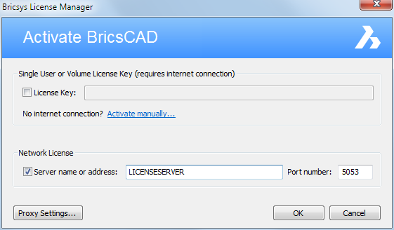

Do one of the following:
The first time BricsCAD is started - In the Activate BricsCAD dialog, click the Activate Now... button.
When starting BricsCAD in trial mode - In the Free Trial dialog, click the Enter License... button.
When replacing or upgrading an existing license - In the Help menu, choose BricsCAD License... . The Licensing Information dialog opens. Click the Modify... button.
The Activate BricsCAD dialog opens.
Check the Network License option.
Type the host name or IP address of the license server in the
Server name or address field.
(Optional) Type the port number in the Port Number field.
If your computer connects to the license server through a proxy server, click the Proxy Settings... button to configure the proxy settings for a network license.
Click the OK button.
