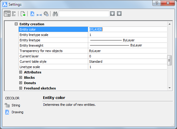

Sets default values for creating entities (short for "dynamic dialog entity modes").
command bar: ddemodes
alias: settings
: ddemodes
Displays Settings dialog box at the Entities section:
Change settings, and then click X.
Entity Color |
Specifies the default color of new entities; default is ByLayer, which means that entity colors are governed by layer properties. |
Entity Linetype Scale |
Specifies the default scale factor for linetypes; default is 1.0000. |
Entity Linetype |
Specifies the default linetype for new entities; default is ByLayer, which means that entity linetypes are governed by layer properties. |
Entity Lineweight |
Specifies the default linetype for new entities; default is ByLayer, which means that entity lineweights are governed by layer properties. |
Current Layer |
Specifies the default layer for new entities; default is layer 0. |
Current Table Style |
Specifies the default table style for new tables. |
Linetype Scale |
Specifies the global linetype scale factor; this factor affects entity linetype scale factors. |
