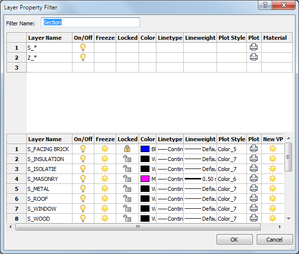

To create a new layer filter definition:
  1. Click the New button () on the Filter Panel toolbar.
    The Layer Property Filter dialog box displays:
  2. Type a search string in the Filter Name field.
    Accepted wild-card characters are listed in the Wild-Card Table below.
  3. (option) Type a search string in the Layer Name field (see Filter Text).
  4. (option) Click a property column, then set a filter criterion for this property.
    Multiple properties can have criterion applied.
  5. (option) Repeat steps 3 and 4 for each new row in the layer filter definition.
  6. Click the OK button to save the layer filter.

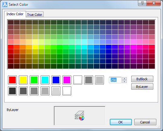

Color
Specifies the color of the layer. Default color is white (black).
To change the color:
1. Click a color square to see the Select Color dialog box.
2. Choose a color, and then click OK.
See Color command.
