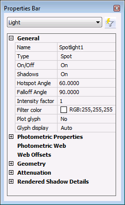

The general properties are common to all lights:
- Name: a user
defined name for the light.
- Type: defines the
type of light: spot, point, web or distant.
- On/Off: specifies
whether the light is turned on or off.
- Shadows: specifies
whether the light casts shadows or not. Turning shadows off to
increases performance.
- Intensity factor:
multiplies the Lamp Intensity
property, the result is the Resulting
Intensity.
- Filter color:
defines the color of the light.
- Plot glyph: if on,
the light glyphs are plotted.

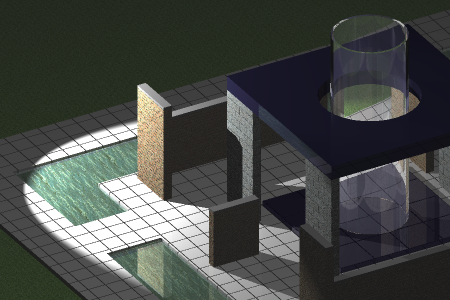

Spotlight hotspot and
falloff properties
When a surface is illuminated by a spotlight, there is an area
of maximum illumination (hotspot) that is surrounded by an area of
lesser intensity (falloff).
- Hotspot angle:
angle of the central light cone (defines the hotspot)
- Falloff angle:
angle of the full light cone
Hotspot angle = 55, Falloff angle = 60
Hotspot angle = 30, Falloff angle = 60
The difference between the hotspot angle and the falloff angle
defines the area of lesser light intensity.
If the falloff angle and the hotspot angle are almost equal
the edge of light cone is rather sharp (left).
The greater the difference between both angles, the softer the
edge of the light cone (right).

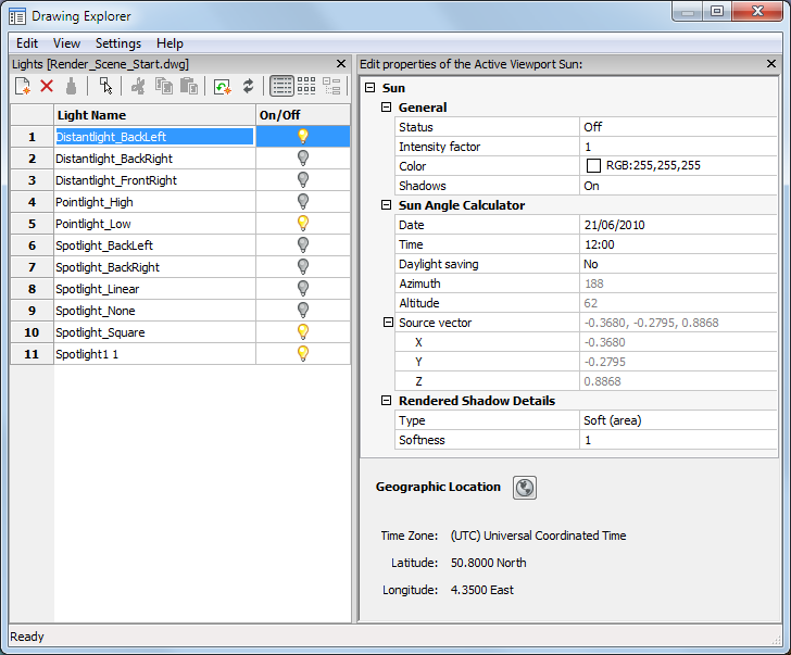

To open the light
list in the Drawing Explorer
Do one of the following:
- Click the Light
List... button (
) on the Lights toolbar.
- Choose Drawing
Explorer > Lights in the Tools menu.
- Choose Light
List.. in the View | Rendering |
Lights menu
- Type lightlist
or LL in the command bar, then press
Enter.
Icon
Tool name
New light
Closes the Drawing Explorer -
Lights dialog, then guides you to the creation of a new
light in the drawing.
Delete light
Deletes the selected light.
Select in drawing
Lights dialog and selects the light's glyph in the
drawing.
The properties of the light display in the Properties
Bar.
Light ON
Click to switch light off.
Light OFF
Click to switch light on.

To edit a light
- Select the light in the drawing.
If the Properties bar is not open yet, double click the light.
The properties of the selected light display in the
Properties Bar:
- To edit a property:
- Expand the settings group if needed.
- Select the property
- Edit the selected property.
To define the sun
properties
- Do one of the following:
- Click the Sun
Properties... tool button (
) on the Render toolbar.
- Type sunproperties or sun in the command bar, then press Enter.
The Drawing Explorer -
Lights dialog displays, showing the sun properties in the
Editor pane.

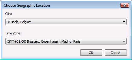

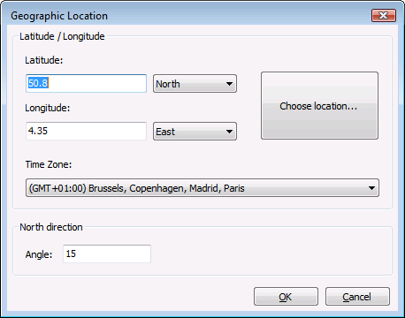

- Click the Geographic
location... tool button (
) on Editor pane of the Drawing
Explorer - Lights dialog.
- Type geographiclocation or geo in the command bar, then press Enter.
The Geographic
Location dialog displays:
- Type the latitude and longitude of the
location in the Latitude and
Longitude fields and select the
appropriate hemisphere for each setting.
- Click the Choose
location... button, then select a city and timezone and
click the OK button.
- Choose a time zone in the Time Zone list.
- Define the direction of the north.
- Click the OK
