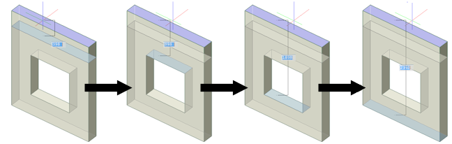

Adds or removes volume from a solid by moving a face.

Select faces to push/pull: (select one or more faces or detected boundaries on the same or different solids; press and hold the TAB key to select hidden geometry. Press Enter to stop selecting geometry.)
Entities in set: 2
Specify distance: (Specify a point or type a distance.)
The selected geometry is edited dynamically.
Do one of the following:
Specify a point.
Type a value in the dynamic entry field.
Hit the TAB key to select a different reference face. The current
reference face highlights. All faces which are parallel to the face
being pushpulled are recognized, the nearest first. Press and hold
the Shift key when hitting the TAB key to cycle reference faces in
reverse order.
Planar faces |
The faces are moved, thus adding or removing volume from the solid(s). The value of the movement vector displays in the dynamic entry field. |
