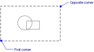

Window
W
Selects all entities fully inside a rectangular selection window; prompts you:
First corner of inclusive window - specify the first point of the selection rectangle.
Opposite corner - specify the other corner.

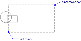

Crossing
C
Selects all entities inside and crossing a rectangular selection window; prompts you:
First corner of crossing window - specify the first point of the selection rectangle.

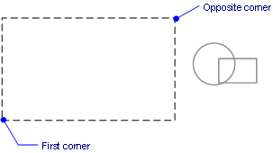

Outside
O
Selects all entities fully outside a rectangular selection window; prompts you:
First corner of exclusive window - specify the first point of the selection rectangle.

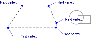

Crossing polygon
CP
Selects all entities inside and crossing a polygonal selection window; prompts you:
First vertex of crossing polygon - specify the first point of the selection polygon.
Next vertex - specify the next point.
Next vertex - press Enter to close the vertex.

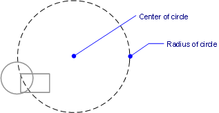

Crossing circle
CC
Selects all entities inside and crossing a circular selection window; prompts you:
Center of circle - pick a point.
Radius of circle - specify a radius by picking or entering a value.

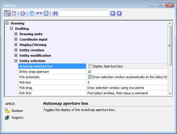

Settings
D
Displays the Entity Selection section of the Settings dialog box.
