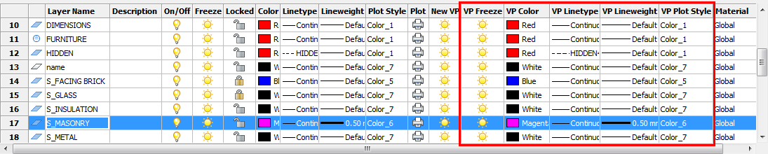

When you open the Drawing Explorer - Layers dialog when in paper space, additional columns display: New, VP Freeze, VP Color, VP Linetype, VP Lineweight and VP Plot Style (VP is short for Viewport). By default, these columns match the corresponding model space settings. VP layer properties can be set differently for each layout and for each paper space viewport.
If SHOWLAYERUSAGE is on, the Layer Usage icons indicate whether VP settings for the current layout or paper space viewport are different from the model space settings:
: Current layer with VP
overrides.
: Layer with VP overrides.
: Empty layer with VP
overrides.
If no paper space viewport is active, the VP settings apply to entities in the current layout.
If a viewport is active, the VP settings override the BYLAYER properties in the current viewport.

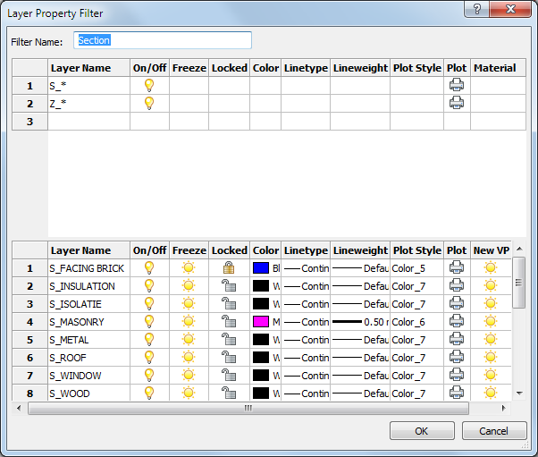

To create a new layer filter definition:
Click the Invert Filter button to invert the current filter. |
