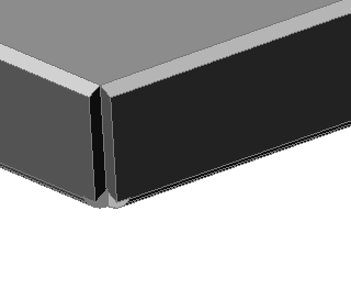

Closes gaps between two arbitrarily oriented flanges.

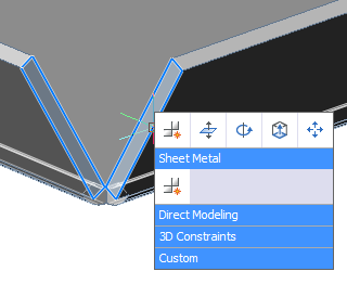

Select planar thickness faces of two flanges: (Select the face on the first flange.)
Entities/subentities in set: 1
The flanges are connected.
If SELECTIONPREVIEW is 2 or 3, thickness faces of flanges highlight. Press the TAB key to select obscured faces.
Quad cursor menu
Select the planar thickness faces of two flanges, then choose
Connect Flanges (
) in the Sheet Metal
command group.
