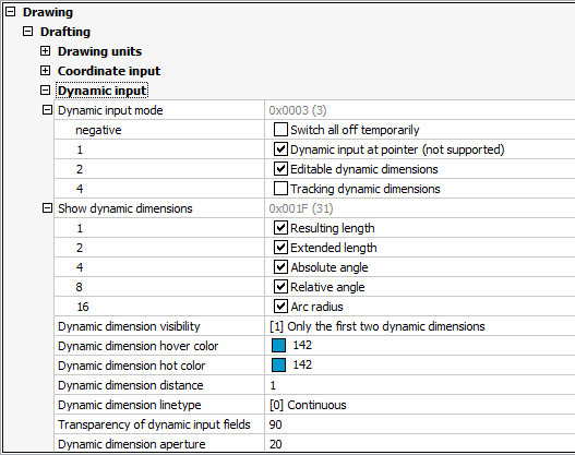

Defining the
Dynamic Dimensions Settings
- Right click the DYNMODE field in the
Status Bar, then choose Settings
in the context menu.
The Dynamic input
settings in the Settings
dialog display:
- Define the DYNMODE
system variable, to switch the display of dynamic dimensions and/or
dynamic input on/off.
Please notice that dynamic input at the pointer is not implemented
yet.
- Define the DYNDIGRIP
system variable, to select the dynamic dimension types to be
displayed.
Distance fields have a blue background; angle fields have a green
background.
- Resulting length: total length of the line
or polyline segment
- Extended length: incremental length of the
line
- Absolute angle: angle relative to the X-axis
of the current UCS
- Relative angle: angle relative to the
original angle of the linear entity
- Arc radius: radius of arcs and circles
- Define the DYNDIVIS
system variable to choose the number of dynamic dimensions that
display simultaneously.
- Only the first
dynamic dimension (DYNDIVIS=0): hit the TAB key to display and edit
the next dynamic dimension, as defined by the DYNDIGRIP system variable.
- Only the first two
dynamic dimension (DYNDIVIS=1): hit the TAB key to edit the next
dynamic dimension, as defined by the DYNDIGRIP system variable and display the next
plus one.
- All dynamic
dimensions as defined by DYNDIGRIP (DYNDIVIS=2): hit the TAB key to edit the next
dynamic dimension
- Set the dynamic dimensions user preferences to
define the appearance (color, linetype and position) of dynamic
dimensions.

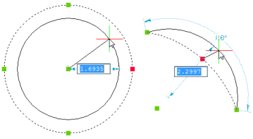

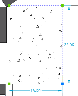

Using dynamic
dimensions to measure entities
- Select the entity or entities.
All grips on the selected entities display.
- Hover the cursor over a grip.
The grip highlights and all dimensions related to the selected grip
display.
Dynamic dimensions used to measure a rectangle (left) and a line
(right).
