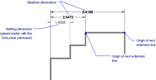

Places multiple linear and angular dimensions starting at the same base point; this command can only be used when at least one other dimension is already in the drawing.
command bar: dimbaseline
aliases: dba, dimbase
menu bar: Dimension | Baseline
toolbar: Dimensions |
: dimbaseline
Baseline: ENTER to select starting dimension/<Origin of next extension line>: (Pick a point to locate the second extension line.)
Dimension text = \A1;2.5472
Baseline: ENTER to select starting dimension/<Origin of next extension line>: (Pick another point, or press Esc to exit the command.)
Baseline dimensions applied to a linear dimension
Baseline dimensions applies to an angular dimension
Chooses the linear or angular dimension from which to continue dimensioning. |
Locates the endpoint of the second extension line; the first extension line is co-located with the first extension of the starting dimension. The command repeats this prompt until you press Esc. |
