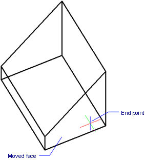

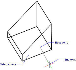

Move
Moves the selected face; prompts you:
Select faces: Remove/Undo/ALL - choose the face(s) to change.
Select faces: Remove/Undo/ALL - press Enter to continue.

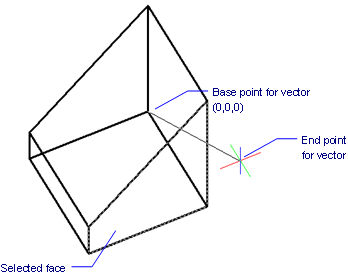

Specify <Base point>/Vector - pick a point, enter x,y,z coordinates, or type V.
Specify end point - pick another point.
See Move command.
Vector
Specifies the displacement through a vector measured from the origin (0,0,0) to the cursor's pick point; prompts you:
Specify end point - pick a point or enter x,y,z coordinates.

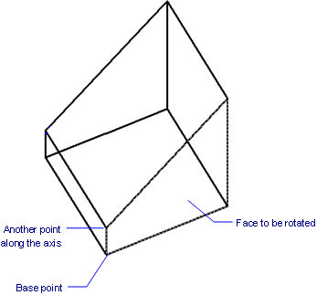

Rotate
Slants the selected face about an axis; prompts you:
Specify the base point - pick the first point of the axis of rotation.
Specify another point along the axis -  pick the axis of rotation's second point.
Specify the rotation angle - enter an angle:
  • Positive angle - face rotates counterclockwise around the axis.
  • Negative angle - face rotates clockwise.
See Rotate command.

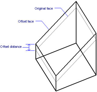

Offset
Extends the selected face; prompts you:
Specify offset distance - enter a distance:
  • Positive distance - face is offset outwards (3D body becomes larger).
  • Negative distance - face is offset inwards (3D body becomes smaller).
See Offset command.

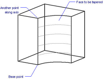

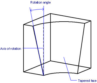

Taper
Tapers the selected face; prompts you:

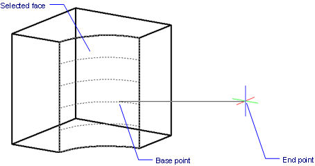

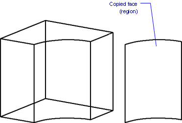

Copy
Copies faces; selected faces turn into regions.
Prompts you:
Specify <Base point>/Vector - pick a point, enter x,yz, coordinates, or type V.
To copy edges to lines, use the Edge |Copy option.
Vector

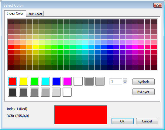

coLor
Changes the color of the selected face; prompts you:
Displays the Select Color dialog box:
Choose a color, and then click OK.
(Note: this option does not work.)

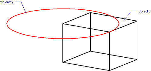

Imprint
Imprints 2D entities onto 3D solids; prompts you:
Select 3d solid - choose a 3D solid.
Select an object to imprint- choose a 2D entity lying on or intersecting at least one face.
Delete the source object Yes/<No> - type Y or N.
  • Yes - deletes the 2D entity.
  • No - does not delete the 2D entity, which can be reused.
Select an object to imprint - choose another 2D entity, or press Enter to end.
The 2D entity must lie on, or intersect, one of the 3D solid's faces.
You can extrude the imprint.

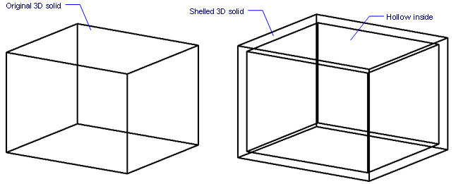

Shell
Turns the 3D solid into a hollow entity (shelled); prompts you:
Remove faces: Add/Undo/ALL - press Enter; removing faces creates unexpected results.
Enter the shell offset distance - specify a distance:
  • Positive distance - shells body outwards.
  • Negative distance - shells body inwards.
If the shell offset distance is larger than the 3D solid, this command fails.

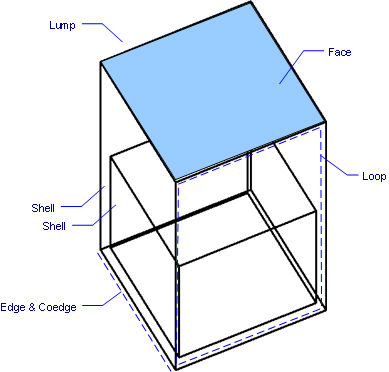

Check
Reports on the 3D solid; prompts you:
A typical report looks like this:
checked:
    1 lumps
    2 shells
    0 wires
    12 faces
    12 loops
    48 coedges
    24 edges
    16 vertices
