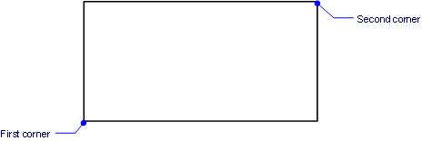

Select first corner of rectangle
Specifies the first corner of the rectangle.
Other corner of rectangle
Specifies the opposite corner of the rectangle.

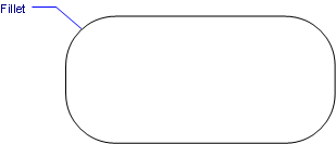

Fillet
Applies a fillet radius to all four corners.
When fillet radius = 0, prompts you:
Fillet distance to use for all rectangles - specify the fillet radius; enter 0 or a positive number.
When fillet radius not 0, prompts you:
Off/Default/Fillet distance to use for rectangles - enter an option.
The same fillet is applied to all four corners.
Caution: when the fillet radius is larger than the rectangle, an invisible rectangle is drawn.
See Fillet command.

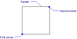

Square
Draws a square; delays the prompt until after the 'Select first corner of rectangle' prompt:
Second corner of square - specify the opposite corner; pick a point, or enter x,y coordinates.
See Polygon command.

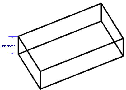

Thickness
Specifies the thickness of the rectangle.
When thickness = 0, prompts you:
Rectangle thickness - specify the thickness; enter 0 or a positive number.
Default/Rectangle thickness - enter an option.
The thickness is the height of the rectangle in the z direction; it is measured upwards from the elevation.
See Elev command.
