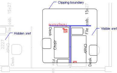

Clips externally-referenced drawings, and adjust front and rear clipping planes (short for "xref clip").
command bar: xclip
alias: clip
menu bar: Modify | XRef Clip
: xclip
Select entities: (Choose one or more xrefs.)
Entities in set: 1
Select entities: (Choose more xrefs, or press Enter to continue.)
ON/OFF/Clipdepth/Delete/generate Polyline/New boundary/<New>: (Enter an option, or press Enter for the default.)
When you enter New, the following options appear:
[Select polyline/Polygonal/Rectangular] <Rectangular>: (Type S, P, or R.)
Prompts for Rectangular option:
Specify first corner: (Pick a point in the drawing, or specify x,y coordinates.)
Specify opposite corner: (Pick another point in the drawing, or specify x,y coordinates.)
The hidden portion of the xref is shown in gray for illustrative purposes only; it is normally not seen when clipping is turned on.
