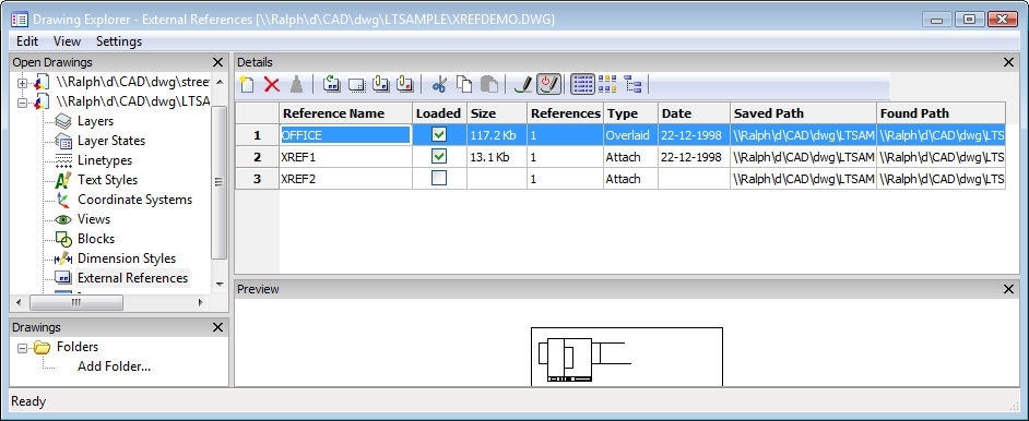

: xref
Displays Drawing Explorer:
Attach a DWG file, or change the properties of existing xrefs, and then click X.
Press F1 to access help.
Reference Name
Specifies the name of the xref. This name is assigned by Bricscad, but can be changed by the user.
Click to rename.
Loaded
Toggles the loading of the xref:
  • On - loads the xref, and makes it visible.
  • Off - unloads the xref, making it invisible.
Click to change the load status.
Size
Reports the size of the xref DWG files. Very large files can slow down the system.
References
Reports the number of times the xref is attached to the drawing.
Type
Reports whether the xref is attached or overlaid:
  • Attach - all xrefs are displayed.
  • Overlay - only the first xref of nested xrefs is displayed.
To change type, you must unload the xref and then reload it as attached or overlaid.
Date
Reports the date of the file. This can be useful in determining if you ware working with the most recent revision.
Saved Path
Reports the original path to the xref's DWG file when first loaded.
If the path cannot be found, click this field, and then click the button. Bricscad displays the Choose a File dialog box"
  1. Locate the missing DWG file.
  2. Click Open.
Found Path
Reports the current path to the xref's DWG file. This path should match the Saved Path in most cases.
