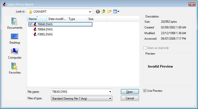

Choose a DWG file, and then click Open.

Overlays xrefs in the current drawing; displays the Select File to Overlay dialog box.

Attaches xrefs to the current drawing;  displays the Select File to Attach dialog box.
