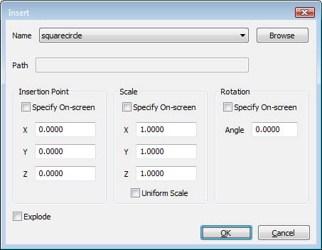

Enter options, and then click OK.
Name
Specifies the name of the block.
The block can exist in the drawing, or be any DWG file:
  • To choose a block in the drawing, enter a name, or click the Name droplist.
  • To choose a DWG file, click the Browse button.
Blocks are created with the Block command.
Browse
Displays the Open dialog box.
Choose a DWG file, and then click Open.
Path
Reports the path to the block, if opened from a DWG file.
Insertion Point
Specifies the insertion point of the block in the drawing.
Specify On-screen
Toggles where you specify the insertion coordinates:
  • Off - specifies the x,y,z coordinates in the dialog box.
  • On - specifies the coordinates  in the command bar after you click OK; prompts you:
Insertion point - specify the x,y or x,y,z coordinates of the block's lower left corner.
X
Specifies the x coordinate of the block's insertion point.
Y
Specifies the y coordinate of the block's insertion point.
Z
Specifies the z coordinate of the block's insertion point.
Scale
Scales the block:
  • Values larger than 1 - make the block larger.
  • 1 - inserts the block at actual size.
  • Values smaller than 1 - make the block smaller.
Specify On-screen
Toggles where you specify the scale factors:
  • Off - specifies the x,y,z scales in the dialog box.
  • On - Specifies the scale factor in the command bar after you click OK; prompts you:
Scale factor - specify the scale factor.
X
Specifies the scale factor along the x axis.
Enter a negative value to mirror the block about the y axis.
Y
Specifies the scale factor along the y axis.
Enter a negative value to mirror the block about the x axis.
Z
Specifies the scale factor along the z axis.
Uniform Scale
Toggles whether or not the same scale factor is used for all:
  • Yes - uses the x scale factor also for the y and z scale factors.
  • No - allows the x, y, and z scale factors to be different from each other.
Rotation
Specifies the rotation angle of the block about its insertion point:
  • Positive angles - rotate the block counter-clockwise.
  • Negative angles - rotate the block clockwise.
Specify On-screen
Toggles where you specify the rotation angle:
  • Off - Specifies the angle in the dialog box.
  • On - Specifies the angle in the command bar after you click OK; prompts you:
Rotation angle - specify the angle.
Angle
Specifies the rotation angle about the insertion point:
  • Positive angles rotate the image counter-clockwise.
  • Negative angles rotate the image clockwise.
Explode
Toggles whether the block is inserted exploded:
  • Yes - explode block; it is inserted with its constituent parts.
  • No - does not explode block; it is inserted as a block.
