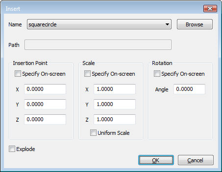

Inserts blocks, through a dialog box.
command bar: insert
aliases: i, ddinsert
menu bar: Insert | Insert Block
toolbar: Draw 2D | ![]()
status bar: Name
: insert
Enter options, and then click OK.
Specifies the name of the block. The block can exist in the drawing, or be any DWG file:
Blocks are created with the Block command. |
Displays the Open dialog box. Choose a DWG file, and then click Open. |
Reports the path to the block, if opened from a DWG file. |
Specifies the insertion point of the block in the drawing.
Toggles where you specify the insertion coordinates:
Insertion point - specify the x,y or x,y,z coordinates of the block's lower left corner. |
Specifies the x coordinate of the block's insertion point. |
Specifies the y coordinate of the block's insertion point. |
Specifies the z coordinate of the block's insertion point. |
Scales the block:
Toggles where you specify the scale factors:
Scale factor - specify the scale factor. |
Specifies the scale factor along the x axis. Enter a negative value to mirror the block about the y axis. |
Specifies the scale factor along the y axis. Enter a negative value to mirror the block about the x axis. |
Specifies the scale factor along the z axis. |
Toggles whether or not the same scale factor is used for all:
Specifies the rotation angle of the block about its insertion point:
Toggles where you specify the rotation angle:
Rotation angle - specify the angle. |
Specifies the rotation angle about the insertion point:
Toggles whether the block is inserted exploded:
