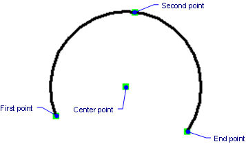

The first time a drawing command is used in a drawing, you are prompted in the command bar:
Center/<Start of arc>: (Pick a point, enter coordinates, or enter an option.)
Angle/Center/Direction/End/Radius/<Second point>: (Pick a point, enter coordinates, or enter an option.)
End point: (Pick a point or enter coordinates.)

This command draws arcs by 17 methods. You can see the full list in the Draw | Arc menu and the Arcs toolbar:
Continues the arc tangent from the last point picked. |
Specifies the center point of the arc. |
Continues the arc tangent from the last point picked (same as pressing Enter). |
Specifies a different start point for the new arc. |
Specifies the included angle, the angle between the arc's start point and:
Specifies the center point of the arc; after this, you can specify one of the following to complete the arc:
Specifies the direction of the tangent to the arc's start point; following this, you specify the following:
Specifies the arc's end point; following this, you can specify the following:
Specifies the arc's radius; following this, you can specify the following:
Specifies a point along the arc's circumference; following this, you specify the following:
