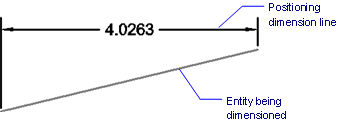

ENTER to select entity/<Origin of first extension line>: (Press Enter to dimension an entity.)
Select entity to dimension: (Choose a line, polyline, arc, or circle.)
Angle/Text/Horizontal/Vertical/Rotated: (Position the dimension line, or enter an option.)
Dimension text = \A1;4.0263
ENTER to select entity/<Origin of first extension line>: (Choose a starting point.)
Origin of second extension line: (Choose an ending point.)
Dimension text = \A1;6.6588
Press Enter to dimension a single entity. |
Specifies the line, polyline, arc, or circle to dimension; other entities cannot be dimensioned with this option. |
Locates the dimension line away from the entity; determines the length of the extension lines. |

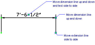

Grips Editing
Linear dimensions can be edited directly through grips:
Select the linear dimension. Notice the grips.
Drag either grip on the dimension line to move the dimension line; the extension lines change length.
Drag the grip on the text to relocate it; the dimension line moves along, and a leader line is added, if required.
Drag either grip on the extension lines to move the extension line; the dimension line changes length.
