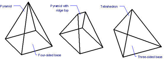

This command draws:
To draw a rotated pyramid, specify the angle during the Apex option.

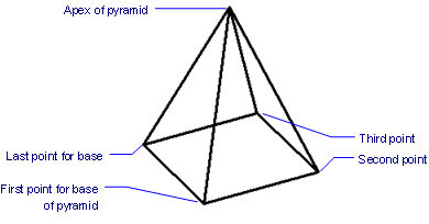

First point for base of pyramid
Specifies the first corner of the pyramid's base.
Second point
Specifies the second corner of the base.
Third point
Specifies the third point of the pyramid's base, or the last point for a tetrahedron's base.
Last point for base
Specifies the fourth point for the pyramid's base.
Apex of pyramid
Specifies the height and angle of the pyramid; draws a pointy top.

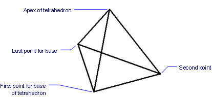

Tetrahedron
Draws tetrahedrons; prompts you:
Apex of tetrahedron - specify the top of the tetrahedron.

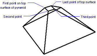

Top surface
Draws a flat surface at the top of the pyramid; prompts you:
First point on top surface of pyramid - specify the starting corner of the pyramid's flat top.
Second point - specify the next corner.
Third point - specify the third corner for pyramid, and the last corner for a tetrahedron.
Last point of top surface - specify the fourth corner for the pyramid.

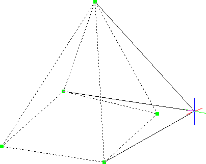

Grips Editing
Mesh-formed pyramids can be edited directly through grips:
  1. Select the pyramid. Notice that it has one grip at each vertex.
  2. Drag the grip to move the adjacent faces.
