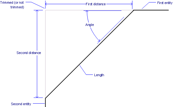

Angle
Prompts you for the Chamfer length and Chamfer angle in the command bar and sets the Chamfer mode to Length-Angle.
Distance
Prompts you for the Chamfer first distance and Chamfer second distance in the command bar and sets the Chamfer mode to Distance-Distance.

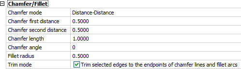

Settings
Setting
Chamfer Mode
Determines how the chamfer is created:
  • Distance-Distance - specify two distances.
  • Length-Angle - specify length and angle.
Chamfer First Distance
Specifies the default value of the first chamfer distance.
Chamfer Second Distance
Specifies the default value of the first second distance.
Chamfer Length
Specifies the default length of the chamfer.
Chamfer Angle
Specifies the default angle of the chamfer.
Trim Mode
Toggles whether intersecting entities are trimmed:
  • Yes - trims intersecting entities back to the chamfer.
  • No - does not trim intersecting entities.
