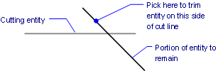

Select entity to trim
Chooses the entity to be trimmed.
Select a single entity; only one entity can be trimmed at a time.
Your pick point defines the portion of the entity to be removed.

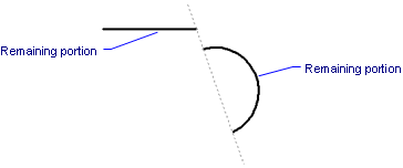

Edge mode
Toggles edge mode; prompts you:
Extend/No extend - type E or N.
  • Extend - trims entities that do not physically intersect the cutting entity.
  • No extend - trim only entities that intersect.

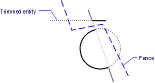

Fence
Cuts entities interactively; prompts you:
First point of fence - specify the fence's starting point.
Next fence point - specify the next point; press Enter to exit this option.
As you pick fence points in the drawing, BricsCAD immediately trims entities under the fence.
The portion of each entity between other entities is trimmed:
Use this option together with ALL (select all entities to trim).
