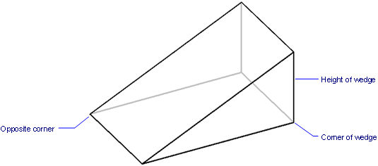

Corner of wedge
Specifies one corner of the wedge's base.
Opposite corner
Specifies the other corner of the base.
Height of wedge
Specifies the height of the wedge. Note that the tall end of the wedge is drawn from the first corner point specified.

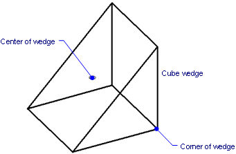

Center
Draws the wedge using a center point and a corner. Prompts you:
Center of wedge - specify the center of the entire wedge (not the base).
Corner of wedge - specify the location of one of the wedge's corners.
Cube
Draws a wedge with equal length, width, and height. Prompts you:
Length of sides of cubic wedge - specify the same distance for each dimension, length, width, and height.

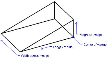

Length
Allows you to enter distances of all three dimensions; don't enter coordinates. Prompts you:
Length of side - specify the length in the x direction; enter a negative number to draw the wedge in the negative x direction.
Width across wedge - specify the width of the base.
Height of wedge - specify the height.
