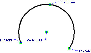

Enter start of arc or [Center]: (Pick a point, enter coordinates, or enter an option.)
Enter second point or [Angle/Center/Direction/End/Radius]: (Pick a point, enter coordinates, or enter an option.)
End point: (Pick a point or enter coordinates.)

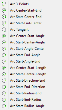

This command draws arcs by 17 methods. You can see the full list in the Draw | Arc menu:
and the Arcs toolbar:
