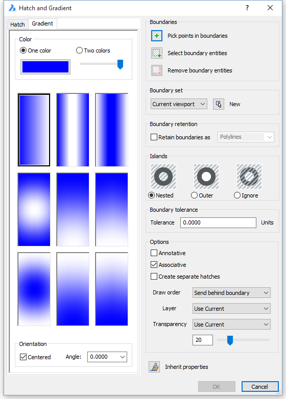

Choose options, and then click OK.
 Color Options  |
 Description  |
 One color: Click the colored tile to choose a different base color. Press and hold the left mouse button to move the slider:
 Two colors: Click the colored tiles to choose a different colors.  |

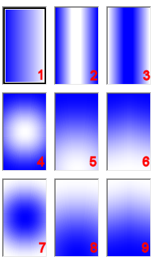

 Gradient fill pattern name: Click a pattern. The options are: Linear (1) - Cylindrical 2() - Inverted Cylindrical (3) Spherical (4) - Hemispherical (5) - Curved (6) Inverted Spherical (7) - Inverted Hemispherical (8) - Inverted Curved (9)  |
 Orientation: Centered: The gradient fill is created symmetrical; Not centered: The gradient fill is built up from the left of the boundary. Angle: Specifies the angle of the gradient fill, relative to the current UCS.  |
 Boundaries  |
 Specifies the closed areas (boundaries) in which to place the hatch pattern; temporarily dismisses the dialog box, and then prompts you at the command bar: Select a point to define a boundary or hatch area - pick a point inside a closed area. Notice that BricsCAD immediately draws the hatch, allowing you to preview its scale factor, angle, origin, and other parameters. The prompt repeats, allowing you to choose additional areas to hatch. When done selecting areas, press Enter: Select a point to define a boundary or hatch area - press Enter to return to the dialog box. You cannot pick an area that already contains a hatch pattern, or areas that are not closed.  |
 Selects the entities that make up a hatch pattern boundary; temporarily dismisses the dialog box, and then prompts you at the command bar: Select entities - use any selection method to choose one or more entities. The prompt repeats, allowing you to choose additional entities. When done selecting entities, press Enter: Select entities - press Enter to return to the dialog box. This option allows you to hatch closed areas that already contain a hatch; it does not hatch open areas.  |
 Prompts you to remove entities from the detected boundary set.  |
 Boundary Set  |
 Specifies where BricsCAD should search for entities that make up the hatch boundary:
 Creates a new selection set of entities that make up the pattern boundary; temporarily dismisses the dialog box, and then prompts you at the command bar: Select entities - use any selection method to choose one or more entities. The prompt repeats, allowing you to choose additional entities. When done selecting entities, press Enter: Select entities - press Enter to return to the dialog box. The next step is to click the Pick Points in Boundaries button to choose the hatch area. If a selection exists when you launch the Gradient command, and if PICKFIRST is ON, the Hatch and Gradient dialog box immediately reopens when you click the New button.  |
 Boundary Retention  |
 Toggles whether boundaries are retained:
 Specifies the entity used for the boundary: Polylines - makes the boundary from a polyline.  |
 Islands  |
 When a closed hatch boundary contains other boundaries, BricsCAD hatches alternating areas.  |
 When a closed hatch boundary contains other boundaries, BricsCAD hatches only the outermost area.  |
 When a closed hatch boundary contains other boundaries, BricsCAD hatches all interior areas, as if they were not present.  |
 Boundary Tolerance  |
 Specifies the largest gap BricsCAD ignores when hatching a boundary that is not fully closed. The gap tolerance is saved in the HPGAPTOL system variable.  |
 Options  |
 Sets the Annotative property of the hatches.  |
 Toggles the associativity of hatch patterns:
 The Associative option is not available for annotative hatches.  |
 If checked, creates a separate gradient entity for each boundary in the selection. If not checked, creates a compound gradient entity.  |
 Specifies where the pattern should be placed relative to other entities:
 Allows to create the gradient fill on a specified layer, rather than on the current layer. Click the list button, then select a layer.  |
 Allows to set the Transparency property of the gradient fill. The options are:
 The Transparency value for new hatches is saved by the HPTRANSPARENCY system variable.
 Copies the properties of another, existing gradient entity; temporarily dismisses the dialog box, and then prompts you at the command bar: Select hatch entity to copy properties from: (Use any selection method to choose a single hatch pattern.) This button is useful for quickly setting options of a new hatch based on existing hatches.  |
