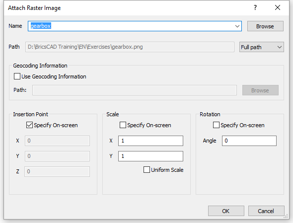

Options
Name
Specifies the file name of the image.
Browse
Displays the Open dialog box; click this button to choose a different raster file.
Choose a raster file, and then click Open.
Path
Reports the path to the image file; cannot be edited by the user.
Full Path
Determines how much of the path is stored:
  • Full Path - stores the full path to the file, including drive and folder names. For example:
c:\foldername\imagename.ext
  • Relative Path - stores the path from the drawing's location to the image's location; the drawing must be saved before this option can be selected. For example:
..\foldername\imagename.ext where .. refers to the folder above the current one.
  • No path - the path is discarded.
Geocoding Information
Position files or world files have an extension that depends on what kind of image file they are associated with.
See explanatory notes below: "About Geocoding Information".
Use Geocoding Information
Toggles use of a position file, which specifies the size, location, and rotation of the image file:
  • Yes - uses a position file.
  • No - does not use a position file.
Path
Reports the path to the position file.
Browse
Displays the Select Image Position File dialog box; choose a TWF file, and then click Open.
Insertion Point
Positions the lower left corner of the image in the drawing. This option is unavailable when a position file is used.
Specify On-screen
Toggles where you specify the insertion coordinates:
  • Off - Specifies the x,y,z coordinates in the dialog box.
  • On - Specifies the coordinates after you click OK, in the command bar:
Insertion point - specify the x,y or x,y,z coordinates of the image's lower left corner.
XYZ
Specifies the x-, y- and z-coordinate of the image's lower left corner.
Scale
Sizes the image. This option is unavailable when a position file is used.
Specify On-screen
Toggles where you specify the scale factors:
  • Off - Specifies the x,y,z scales in the dialog box.
  • On - Specifies the scales in the command bar after you click OK:
Scale factor - specify the scale factor.
XY
Specifies the scale factor in the x and y direction:
  • Values larger than 1 make the image larger.
  • 1 inserts the image at actual size.
  • Values smaller than 1 make the image smaller.
Uniform Scale
Makes the Y scale factor equal to X.
Rotation
Rotates the image about the insertion point.
Specify On-screen
Toggles where you specify the rotation angle:
  • Off - Specifies the angle in the dialog box.
  • On - Specifies the angle  in the command bar after you click OK:. Prompts you:
Rotation angle - specify the angle.
Angle
Specifies the rotation angle about the insertion point.
  • Positive angles rotate the image counterclockwise.
  • Negative angles rotate the image clockwise.

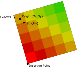

Position files (or world files) are plain ASCII text files that position raster files in the drawing. They are useful for positioning images according to geographic coordinates, such as latitude and longitude. They can be created using text editors such as Notepad.
The format is a list of 6 numbers that fully describe location, scale and orientation of the top left pixel of the raster file to be attached.
If U is the vector along the width, V is the vector along the height, and O is the center of the pixel (see image below):
then the list consists of:
Ux
Uy
Vx
Vy
Ox
Oy
Typically, the first and last letters of the image extension are used with a ”w” added at the end. Sometimes the full image extension with a ”w” at the end is used also.
