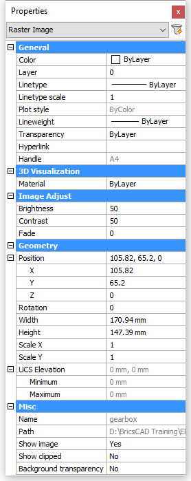

Displays the properties palette:
Change properties.

General Properties
The following properties affect the frame that surrounds the image:
Color
Specifies the color of the frame. See Color command.
Layer
Specifies the layer of the frame.
When the image is placed on its own layer, you can use layer visibility to toggle the display of the image and its frame.
Use the ImageFrame command to toggle the display of the frame independently of the image. See Layer command.
Linetype
Specifies the linetype of the frame. See Linetype command.
Linetype Scale
Specifies the linetype scale of the frame. See LTSCALE system variable.
Plot Style
Specifies the plot style of the frame.
This option is available only when plot styles are enabled in the drawing, See PlotStyle command.
Lineweight
Specifies the lineweight of the frame. See LWeight command.
Hyperlink
Specifies a URL or path to a file. See Hyperlink command.
Image Adjust
The following properties affect the image:
Brightness
Lightens and darkens the image:
  • 0 - very dark or black.
  • 50- normal.
  • 100 - very light or white.
Contrast
Increases and decreases the contrast:
  • 0 - very low contrast.
  • 50- normal.
  • 100 - very high contrast.
Fade
Fades the image:
  • 0 - no fade.
  • 100 - fully faded.
Geometry

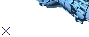

Position
Specifies the x, y, and z coordinates of the image's lower right corner.
When you change the coordinates, the lower right corner is marked with a large X.
Rotation
Specifies the rotation angle about the position point:
  • Positive angles - rotate the image counter-clockwise.
  • Negative angles - rotate in the image clockwise.
Width
Specifies the width of the image, in current units.
Height
Specifies the height of the image, in current units.
Scale
Specifies the scale factor of the image:
  • Less than 1 - makes the image smaller.
  • More than 1 - makes the image larger.
Misc
Name
Reports the name of the image; cannot be edited by the user.
Path
Reports the path to the image file; cannot be edited by the user.
Show Image
Toggles display of the image:
  • Yes -  shows the image; this can be overridden by setting the layer to Frozen.
  • No - hides the image.
Show Clipped
Toggles clipping:
  • Yes - displays clipped image, if clipping has been previously applied by ImageClip command; part of the image is hidden.
  • No - hides clipped portion(s); the full image is displayed.
See ImageClip command.
Background Transparency
Toggles the background  transparency:
  • Yes - makes the background color of the image.
  • No - keeps the image nontransparent.
Transparency makes one color of the image see-through. See Transparency command.
