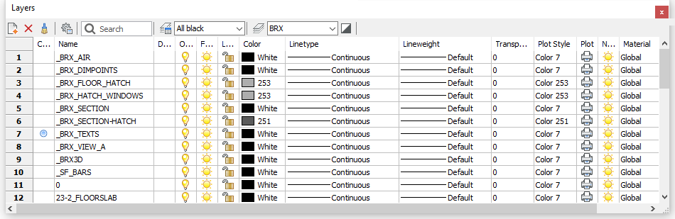

Displays a dialog box:
Layers dialog box in model space

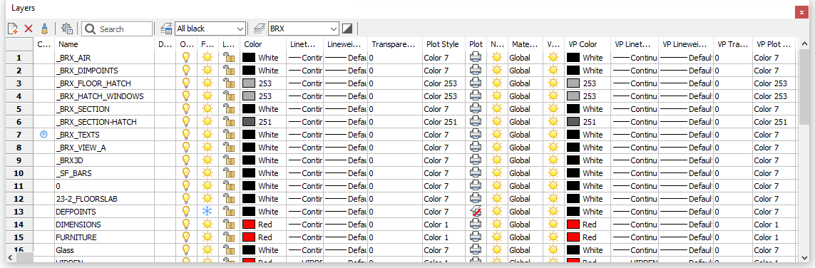

Layers dialog in paper space with the extra VP layer properties which apply to the current paper space layout or a viewport in the current layout.

Specifies the name of the layer.
(option) Describes the content of the layer. Click the field, then type. |
Toggles the selected layers between on and off:
Click a lightbulb icon to change its status. |
Toggles the selected layers between frozen and thawed:
Click an icon to toggle its status. |
Toggles the selected layers between locked and unlocked:

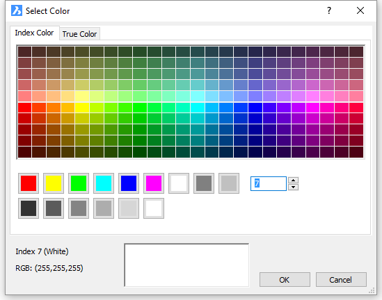

Specifies the color of the layer. Default color is white (black). To change the color: 1. Click a color square to see the Select Color dialog box.
2. Choose a color, and then click OK. See Color command. |
Specifies the linetype of selected layers. Default is "Continuous." To change the linetype:
To load additional linetype definitions:
See Linetype command. |
Specifies the linetype of selected layers. Default is "Default." To change the lineweight:
See LWeight command. |
Specifies the plot style of selected layers. Default is "Color_7." To change the plot style"
Plot styles are available only when they are enabled in the drawing; by default, they are not. See PlotStyle command. |
Toggles the selected layers between plotable and not plotable:
Specifies whether the layer is visible (thawed) or invisible (frozen) in a new layout viewport. |
Specifies the material of selected layers. Default is "Global." To change the material:
Sets the Transparency factor between 0 (fully opaque) and 90 (fully transparent). The TRANSPARENCYDISPLAY system variable controls the display of the transparency in the 2DWireframe visual style. Rendered visual styles always display transparency. |
