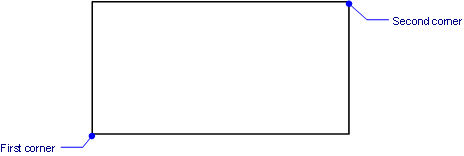

Chamfer/Elevation/Fillet/Rotated/Square/Thickness/Width/Area/Dimensions<Select first corner of rectangle>: (Pick a point, or enter an option.)
Other corner of rectangle: (Pick another point.)

Specifies the first corner of the rectangle. |
Specifies the opposite corner of the rectangle. |

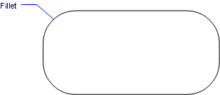

Applies a fillet radius to all four corners. When fillet radius = 0, prompts you: Fillet distance to use for all rectangles - specify the fillet radius; enter 0 or a positive number. When fillet radius not 0, prompts you: Off/Default/Fillet distance to use for rectangles - enter an option.
The same fillet is applied to all four corners. Caution: when the fillet radius is larger than the rectangle, an invisible rectangle is drawn. See Fillet command. |
Off |
Turns off filleting; uses 0 as the fillet radius. |
Default |
Uses the default fillet radius as stored by the Rectang command. This command does not use the FilletRad system variable. |
Fillet distance to use for rectangles |
Specifies the fillet radius; enter 0 or a positive number. |

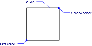

Draws a square; delays the prompt until after the 'Select first corner of rectangle' prompt: Second corner of square - specify the opposite corner; pick a point, or enter x,y coordinates.
See Polygon command. |

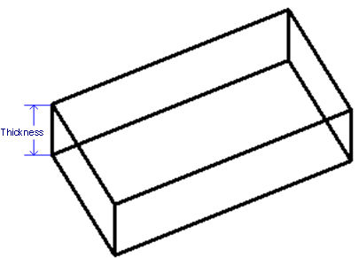

Specifies the thickness of the rectangle. When thickness = 0, prompts you: Rectangle thickness - specify the thickness; enter 0 or a positive number. When fillet radius not 0, prompts you: Default/Rectangle thickness - enter an option.
The thickness is the height of the rectangle in the z direction; it is measured upwards from the elevation. See Elev command. |
Default |
Uses the default thickness as stored by the Rectang command. This command does not use the Thickness system variable. |
Rectangle thickness |
Specifies the thickness; enter 0 or a positive number. |
