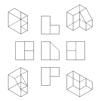

4 orthogonal and 4 isometric views can be generated from an existing drawing view.
Isometric style
Sets the style for isometric views.
Prompts you:
Create isometric views as [3D views / 2D views] <2D>:
The options are:
  • 2D: Isometric views are created as a 2D projection of the 3D geometry.
    Set the display of the  BM_Isometric_Hidden layer on to display hidden lines as dashed lines.

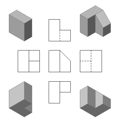

  • 3D: Isometric views show the 3D geometry.
    The Visual Style property of the viewport controls how isometric views display.
