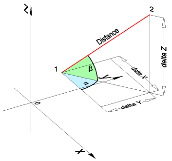

    If DRAGSNAP = 1, the distance displays in the dynamic dimension field.
The following information displays in the command bar (see image below):
Distance, Angle in XY Plane (alpha), Angle from XY Plane (beta),
Delta X, Delta Y, Delta Z.
The values are calculated with respect to the current coordinate system.
