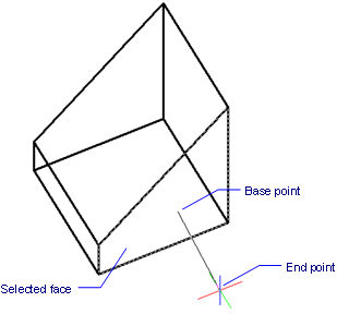

Moves the selected face; prompts you: Select faces: Remove/Undo/ALL - choose the face(s) to change. Select faces: Remove/Undo/ALL - press Enter to continue.
Specify <Base point>/Vector - pick a point, enter x,y,z coordinates, or type V. Specify end point - pick another point.
See Move command. |
Specifies the displacement through a vector measured from the origin (0,0,0) to the cursor's pick point; prompts you: Specify end point - pick a point or enter x,y,z coordinates.
