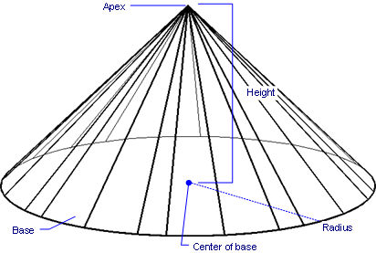

Creates a cone as polygon mesh (Classic); creates a cone as a 3D solid (Pro and Platinum).
command bar: cone
menu bar: Model | 3D Solids | Cone
toolbar: 3D Solids | ![]()
: cone
Elliptical/<Center of base of cone> <0,0,0>: (Pick a point, enter coordinates, or enter an option.)
Diameter/<Radius of base>: (Pick a point, enter coordinates, or type D.)
Apex/<Height of cone>: (Pick a point, enter coordinates, or type A.)
Specifies the center of the cone's base; enter x,y,z coordinates or pick a point. |
Specifies the diameter of the base; prompts you: Diameter of base - enter coordinates or pick a point. |
Specifies the radius of the base; enter coordinates or pick a point. |
Specifies the peak of the cone; prompts you: Apex of cone - pick a point, or enter coordinates. The point you specify determines the height of the cone, as well as the angle at which it is rotated. |
Specifies the height of the cone; pick two points, or specify coordinates. |
Creates cones with elliptical bases. |
Specifies the center of the elliptical base; prompts you: Center of ellipse - pick a point, or enter coordinates. Endpoint of axis - pick another point, or enter coordinates. Other axis - pick a point, or enter coordinates. |
Specifies the endpoint of one elliptical axis. |
Specifies the other end point of the first elliptical axis. |
Specifies the end point of second elliptical axis. |
