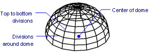

Center of dome: (Pick a point or enter coordinates.)
Diameter/<Radius of dome>: (Pick a point, enter coordinates, or enter R.)
Number of divisions around dome <16>: (Enter a number, or press Enter to keep the default value.)
Number of top-to-bottom divisions <8>: (Enter a number, or press Enter to keep the default value.)
Center of dome
Specifies the center point of the dome's open end; the end is drawn on the current x,y-plane.
Radius of dome
Specifies the radius of the dome.
Changes the number of horizontal isolines used to simulate the dome's curved surface.
Changes the number of vertical isolines from the default of 8.
Diameter
Specifies the diameter of the dome. Prompts you:
Diameter of dome - specify the diameter by pointing or entering a value.
