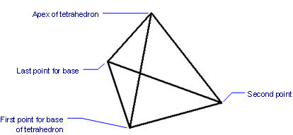

Tetrahedron/<Last point for base>: (Pick the last point, enter coordinates, or type T.)
Ridge/Top surface/<Apex of pyramid>: (Enter an option, pick a point, or enter coordinates.)

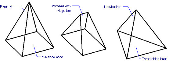

This command draws:
Pyramids with four-sided base and four sides; the base does not need to be an equilateral.
Tetrahedrons with triangular base and three sides; the base can be scalene.
Pyramids with pointed, ridged, or flat tops.

Draws tetrahedrons; prompts you: Apex of tetrahedron - specify the top of the tetrahedron. |

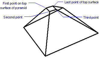

Draws a ridge at the top of the pyramid. Prompts you: Start of ridge specify the height and location of one end of the ridge. End of ridge specify the height and location of the other end of the ridge. |
Draws a flat surface at the top of the pyramid; prompts you: First point on top surface of pyramid - specify the starting corner of the pyramid's flat top. Second point - specify the next corner. Third point - specify the third corner for pyramid, and the last corner for a tetrahedron. Last point of top surface - specify the fourth corner for the pyramid. |

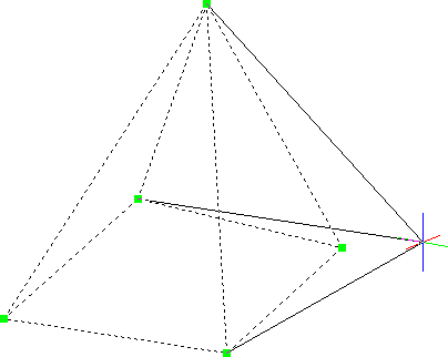

Grips Editing
Mesh-formed pyramids can be edited directly through grips:
Select the pyramid. Notice that it has one grip at each vertex.
Drag the grip to move the adjacent faces.
