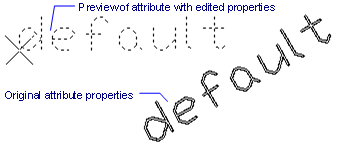

As you change the attribute text, Bricscad previews them:
