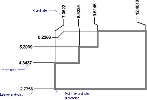

Measures x and y ordinate distances from a common point at the current UCS origin.
command bar: dimordinate
aliases: dor, dimord
menu bar: Dimension | Ordinate
toolbar: Dimensions | ![]()
: dimordinate
Select point for ordinate dimension: (Choose a geometric feature.)
Text/X datum/Y datum/Angle/<Leader endpoint>: (Pick an endpoint for the leader, or enter an option.)
Dimension text = \A1;6.2386
Chooses the start point of the ordinate leader; usually is a geometric feature, such as a corner or circle. |
Forces the ordinate dimension to measure the x distance; the distance is measured from the origin of the current UCS. Move the UCS, if required. |
Forces the ordinate dimension to measure the y distance. |
Specifies the angle of the text; useful for keeping text horizontal with inclined dimension lines. Prompts you: Angle of dimension text - specify the rotation angle of the text. |
Specifies the text; useful for overriding the default measurement generated by BricsCAD. Prompts you: Dimension text - specify the replacement text. |
Specifies the end point of the leader. |
