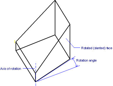

Slants the selected face about an axis; prompts you: Select faces: Remove/Undo/ALL - choose the face(s) to change. Select faces: Remove/Undo/ALL - press Enter to continue.
Specify the base point - pick the first point of the axis of rotation. Specify another point along the axis - pick the axis of rotation's second point. Specify the rotation angle - enter an angle:
See Rotate command. |
